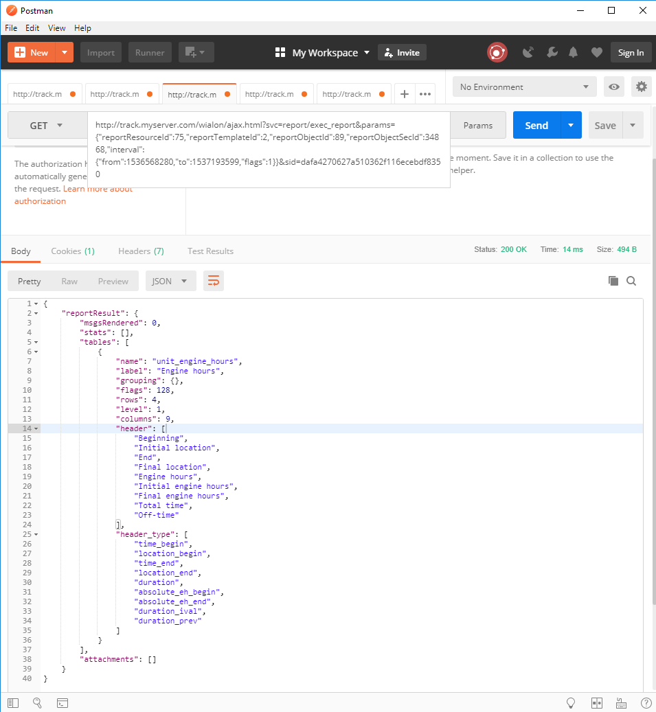

I cant take the data of the header
how can I receive the data of the report

Hello.
To execute and get information to a report template normally you need folow the next steps.
1. report/execute_report.  https://sdk.mos-glonass.com/wiki/en/sidebar/ … ec_report.
2. report/select_result_rows https://sdk.mos-glonass.com/wiki/en/sidebar/ … esult_rows
3. report/cleanup_result https://sdk.mos-glonass.com/wiki/en/sidebar/ … nup_result
You can show a good example on this url
https://sdk.mos-glonass.com/wiki/en/local/re … /reports?s[]=report&s[]=select&s[]=result&s[]=rows

I have another question can I execute report upon some group
custom report
(22/09/2018 19:12:46 отредактировано cerpas)
Re: custom report
ahmedmkazim пишет:
Sure, just you need a group type report (units,drivers, etc) you can see this information in the next link https://docs.mos-glonass.com/en/hosting/user/reports/reports
