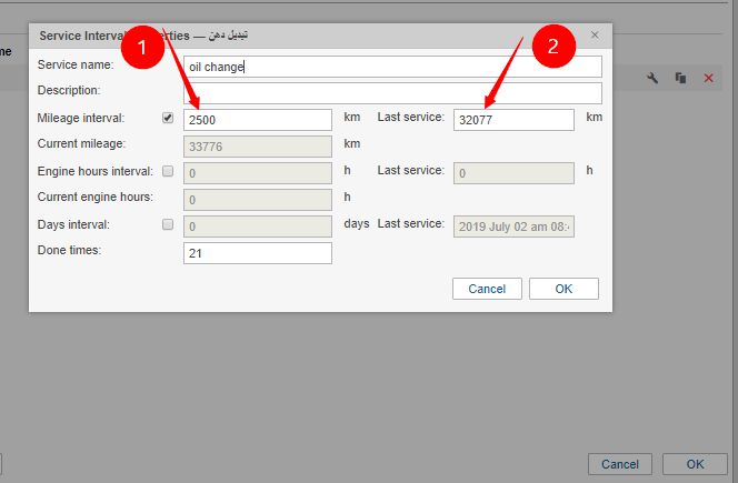

as you see in the image below (the maintenance work) i created an oil change service and pressed OK .
now the unit will countdown from 2500 to zero.
if i export this service to other units, the countdown wont start from 2500 because of the (last service which is NO 2 in the image ), sometimes an invalid data text will appear.
my idea is that when i export the maintenance work i should have the ability to export only the mileage interval without (last service), so when i import it to other units they will all start counting down from 2500 to zero.
hope the idea is clear now
