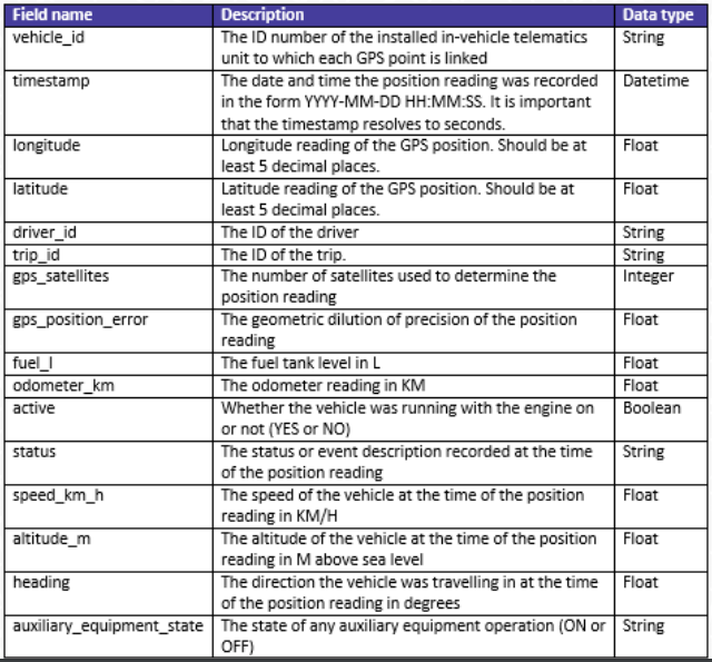

I need to extract the following data from Wialon in a single table:
Is this possible through the API?
Thank you

Thanks for the reply chdi.
We need as many data points as possible, statistics just gives the summary, correct?
And sometimes the messages will have the parameters mapped to different names depending on what device is in the asset.
What's the combination of tables that will give me the closest result to the fields I need? We don't need all of them.. just as many as possible.'
