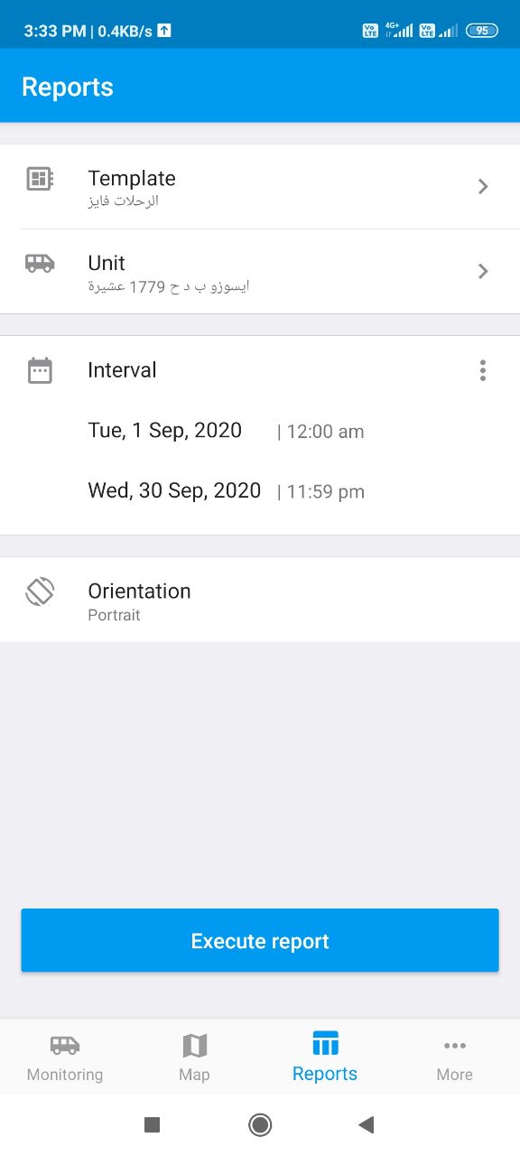

If you can please help me how i can get the report pdf file of the units same wialon App
1) Which API we can integrate to get all template to belong to the account
2) which API should help me to execute the report of the unit and in response get a pdf file with details of the movement with address
Please check I have attached two files
  • How to get Unit Last update date and time
Re: How to get Unit Last update date and time
Hello!
1) To get all reports created in account via request search items or
search item by ID  with flags = 8193 ( base flag + 8192 reports data)
2) To execute report - please look example  https://sdk.mos-glonass.com/wiki/en/sidebar/ … es/reports
3) After report executed you can export it to file - please look the request format here https://sdk.mos-glonass.com/wiki/en/sidebar/ … ort_result
