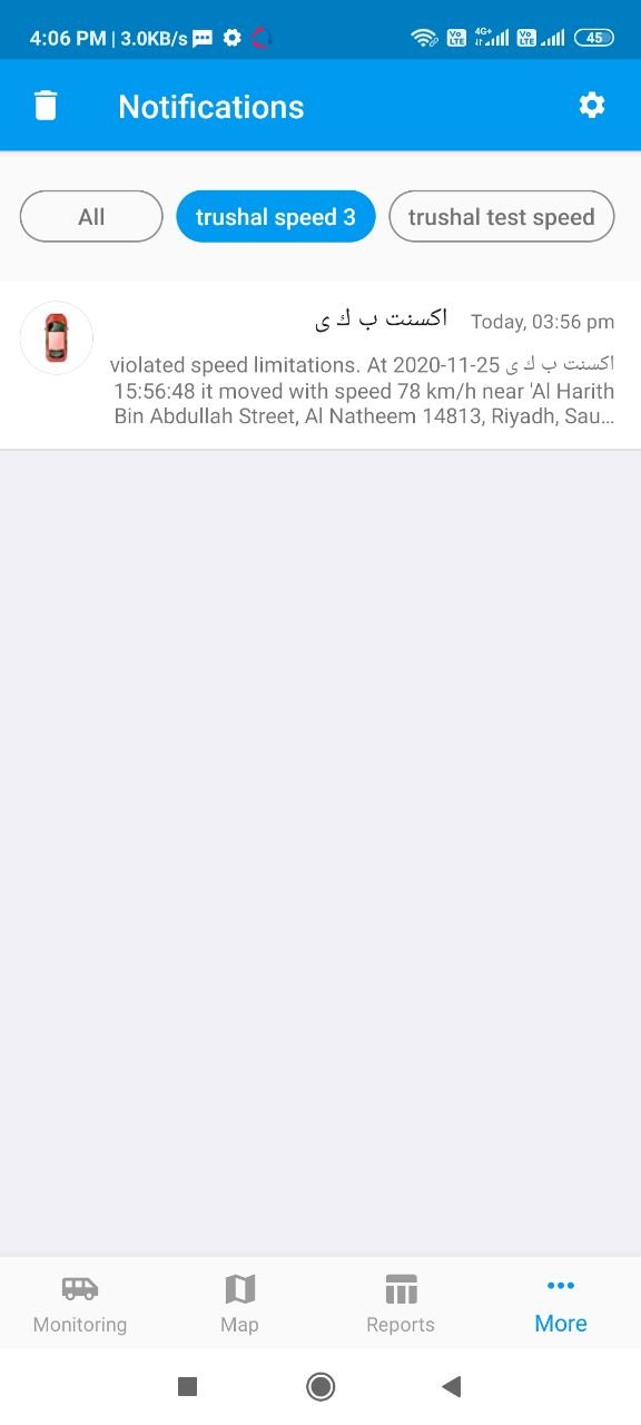

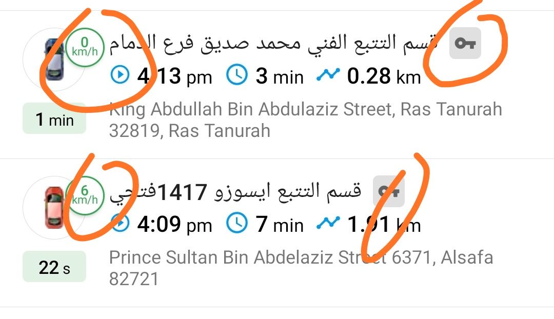

Thanks for all your message,
as your last update that we can not send a push notification with wialon API,
then how i can send any link or any  support that I can set in my application to get notification same as wialon does
also that how I can get a list of notification that user get on a set of notification
i have attached three screenshots that I need to integrate this flow in my current application how i can do that which APi should is use
1) get List of notifications as per request
2) Any support URL that i can integrate to set push notifications the same as wialon app
thanks for your support again
  • How to get Unit Last update date and time

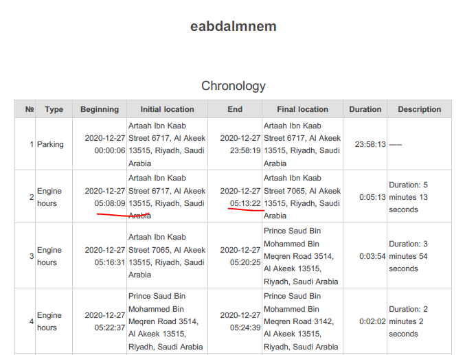

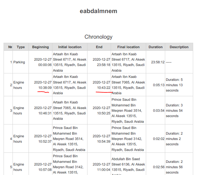

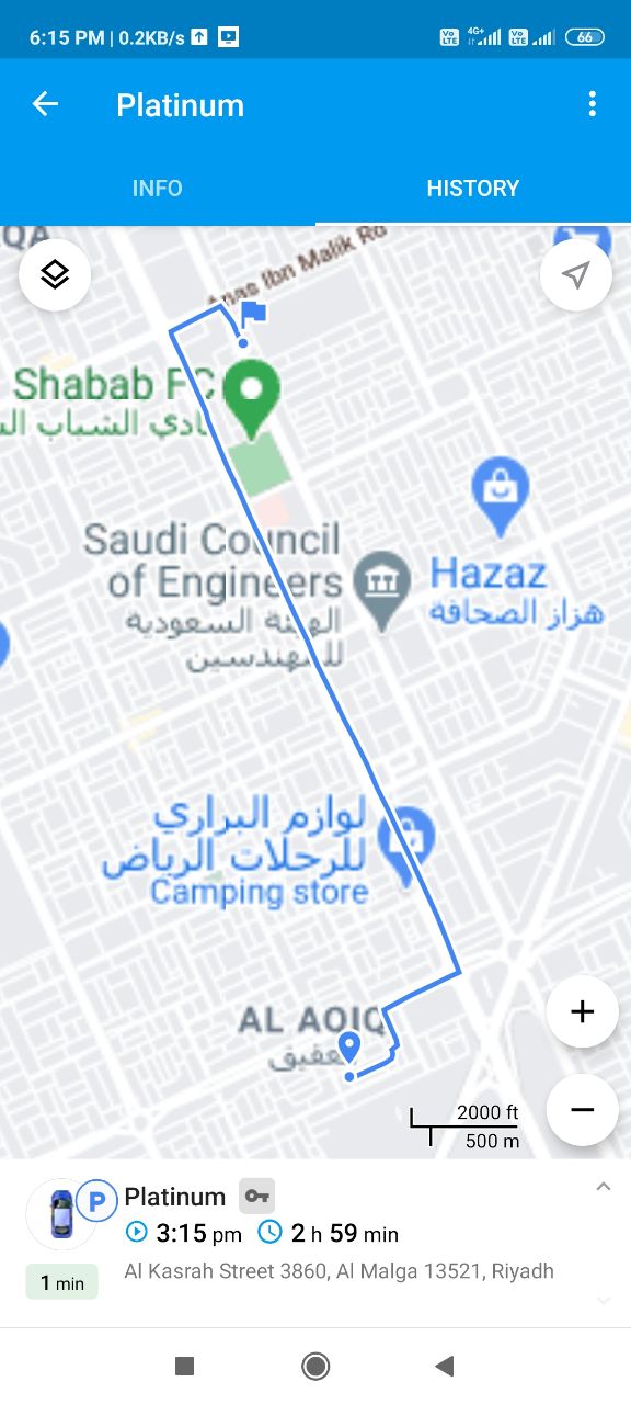

Thanks for your reply,
its works for us to get some movement of the unit with the center of the day but I am not getting if in the parking with start and endpoint
The first trip end time (to time) will be the starting of the parking time(from the time) and the second trip start time will be the end time of the parking event and so on we are calculating parking detail between all the trips.
1. How we can calculate the first parking event of the day which is shown in the attached image as point 1
2. How we can calculate the last parking event of the day which is shown in the attached image as point 2
- If it is the same day event then we are considering the current time as the end time of the last parking event, but for the last day we have considered the end time of the day 11:59 PM but we are not able to calculate that data

Hello!
1. To calculate the first parking in day it depend on your goal, for example you can group events by days, so the day starts from 00:00 to 23:59
and cut the event by begin/end of day.
So to calculate first parking you just calculate time from 00:00 to start 1st trip.
2. The last parking event you can calculate by the end of the day (23:59) , if the day was at history. If it's current day you can calculate by current time
For example, the last trip was end at 09:00 AM, now current time is 9:31, so the current parking is 32 min

Hello if you can please help me to get unit engine status with the bellow cases
How i can get it from API
1) Add key next to the icon when the engine starts it : Green with key when Vehicle is moving and the engine is on,
2) Red with key when the Vehicle stop and the engine is on,
3) Green only if the Vehicle moving without start engine so no key in this situation & red without key if the Vehicle stops and the engine off.
what we have considered that if speed is > 0 then engine status is ON and Speed = 0 then engine status is off but how we should calculate that speed with and engine status with current screens shots

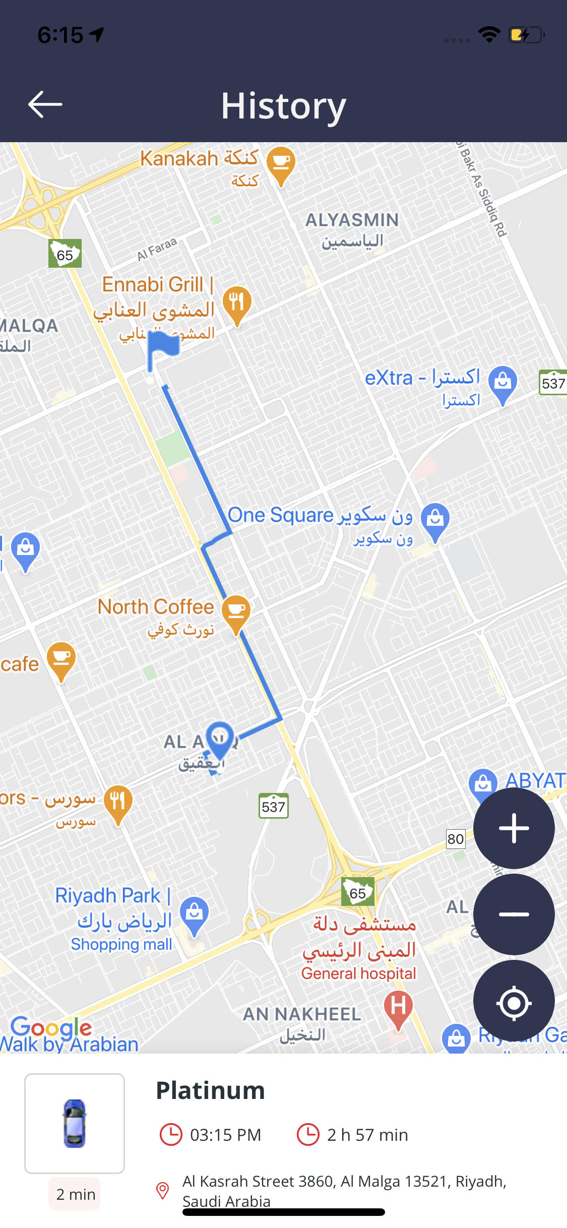

Hello I need to know that as suggested API to get history of trips and its workig like charm, but here we get differet on display rooth path on the map,
svc=events/get
get a response from APi with start and end location
"trips": {
        "0": [
                "from": {
                    "t": 1608526381,
                    "y": 24.7762775421,
                    "x": 46.6249923706
                "to": {
                    "t": 1608527106,
                    "y": 24.7713947296,
                    "x": 46.6237869263
and we use this start and end location as in the below API of the google
https://maps.googleapis.com/maps/api/directions/json?origin=\(source.latitude),\(source.longitude)&destination=\(destination.latitude),\(destination.longitude)&sensor=false&mode=driving&key=\(API_KEY)")
but we are getting the wrong path to compare to Wialon track location path at history page ,
if you can please help me that how i can get this root location from start to endpoint

Hello!
The Wialon is displayed track using Google Polyline Algorithm
When you request trips events, you can get such track in parameter  , just add flag ("detalization")  = 8
For example,
https://hst-api.mos-glonass.com/wialon/ajax.html?svc=events/get&params={"selector":{"type":"trips","timeFrom":1601510400,"timeTo":1608551874,"detalization":9}}&sid=06f3f79ddfad80414a4db
Response
{"trips":{"0":[{"from":{"t":1608377059,"y":46.8571205139,"x":-122.974449158},"to":{"t":1608377259,"y":46.826374054,"x":-122.963294983},"m":1608377483,"f":2,"track":"_x~|GfmqmV??????lo@wdA????vnC?????"},{"from":{"t":1608379499,"y":46.826374054,"x":-122.963294983},"to":{"t":1608379749,"y":46.8789367676,"x":-122.876327515},"m":1608379749,"f":2,"track":"ywx|GngomV??????????????ogI??o~O??"}
Then you can decode 'track' via Google Decode Polyline

Hello thanks for your support
In the report, I request
Between date from 27/12/2020 00:00 AM
Between date To 27/12/2020 11:59 PM
exec_report API:
{"reportObjectSecId":0,"reportObjectId":20306,"interval":{"flags":0,"to":1609113599,"from":1609027200},"reportResourceId":"62290","reportTemplateId":1}"
exec_result API
"extendBounds":0,"pageWidth":0,"format":2,"headings":0,"coding":"utf8","pageSize":"a4","pageOrientation":"portrait","delimiter":"semicolon","attachMap":1,"outputFileName":"eabdalmnem_27/12/2020","hideMapBasis":1,"compress":0}
Above both API working and we are getting report as PDF file
But here the issue is we are not getting proper data with the above post formates
we use to get date as UTC time [timeFormatter.timeZone = TimeZone(abbreviation: "UTC")]
Please check two diff response screenshots
Initial location, Final location, Duration this data are coming proper
But Beginning time and End time coming wrong
