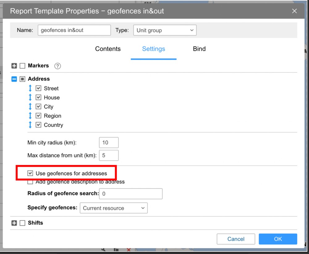

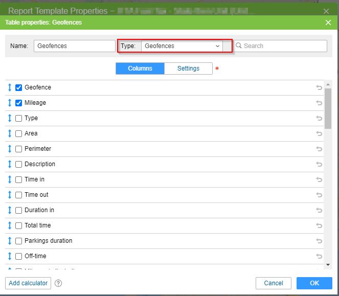

The specified setting is available for all tables within the "Unit" and "Unit group" types of reports. Thus, you could use it for the Geofences table of the Unit type of the report. Please see the setting in the screenshot: the setting is available in the Settings tab of the whole report template - under the Address separator.
It is not available for the Geofences type of the report, though.
