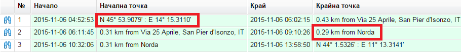

Hello everybody,
We are new in the use of Wialon. Can anybody tell me how to remove the following problem:
Instead the address displayed in reports and the locality. (Street, №, City.). Write coordinates.
  • Coordinates are displayed instead of address
