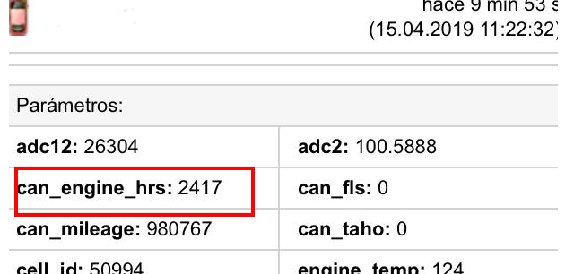

Hi, I'm having trouble getting the sensor value "can_engine_hrs".

On the platform of wialon gives me the following value: can_engine_hrs: 2430
What am I failing ?

Hello!
1. Error 4 -  it's not correct name for parameter source. Please check, you type '"souce":"" . Just slip of the pen.
2. Example of code https://sdk.mos-glonass.com/playground/nd2rz2kG/2 - you specify unit ID (test unit) which doesn't have parameter  can_engine_hrs and it's sensor with id = 3 doesn't have value (unknown value is the same as -348201.3876)
You need to work with your unit, specify it's id
