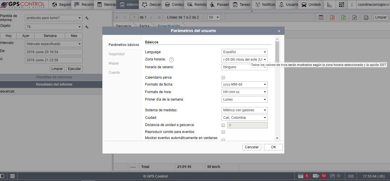

I want to know how I can select a different time zone than the ones
that the platform has pre-established. For example in "User
Parameters" / "Time Zone" (-05: 00) Eastern Time (USA and Canada)
We need to use (UTC-05: 00) Bogotá, Lima, Quito, Rio Branco
The reports currently go out with the area (-05: 00) Eastern Time (USA
and Canada) and for us it is an error because it does not match our
schedule
Thank you

Hello!
ozchamorrito , by default (through Remote API requests) report is executed and returns result in UTC+0 timezone.
If you would like to get result in some other time zone, after login you need to execute request render/set_locale to set up required timezone - parameter tzOffset
Please note sometime it needs to use URL encoded for characters, for example , symbols '%'. Please look example to set up timezone UTC-05: 00
 http://hst-api.mos-glonass.com/wialon/ajax.html?svc=render/set_locale&sid=017642a31bf86ba5f0cfc06d8c3bfbf0&params={"tzOffset":-134170192,"language":"ru","flags":256,"formatDate":"%25Y-%25m-%25E %25H:%25M:%25S"}
