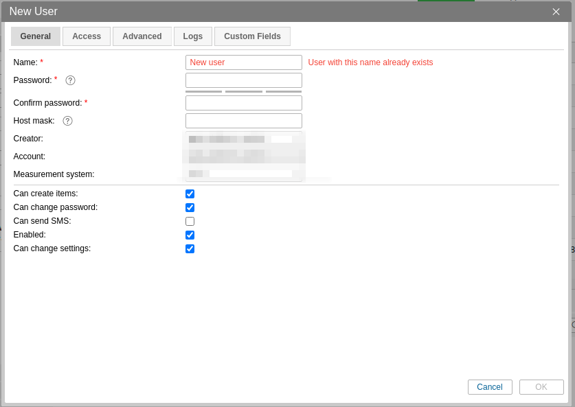

The issue we’re facing is a simple understanding of proper calculation to determine from wialon api when Change Create Item, Can Change Password, Can Send SMS, Enable, Can Change Settings are Checked (enabled) or Unchecked (disabled).
Wialon API accepts a single digit value. This value can be calculated with the sum of all user permission property value’s shown in the screenshot below.
We are not able to calculate the sum. Below is our code example that we have come up with to calculate sum:

Based on the provided code snippet above how would you suggest we determine whether just these variables are checked or unchecked, then how we can edit just one, but not the other, and so on?
can_create_items,can_change_password,can_send_sms,enable,can_change_settings
