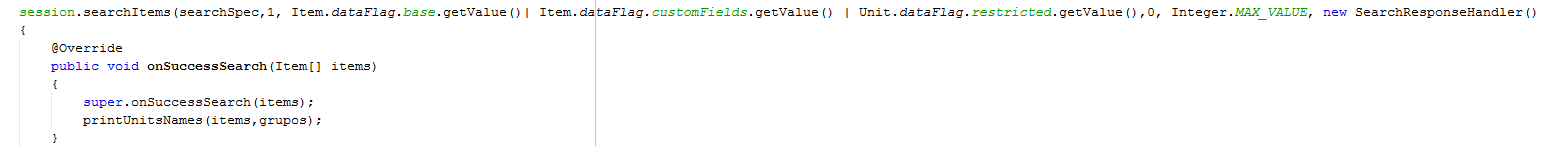

Here is the code

Desarrollo Please check access type for token, which you use.
Parameter access type
Value    Description
0x100    online tracking
0x200    view access to most data
0x400    modification of non-sensitive data
0x800    modification of sensitive data
0x1000    modification of critical data, including messages deletion
0x2000    communication
-1    unlimited operation as authorizated user
(allows to manage user tokens)
http://sdk.mos-glonass.com/wiki/en/sidebar/r … cess_flags
http://sdk.mos-glonass.com/wiki/en/sidebar/r … rmat/token
Mobile Development
UniqueID
Re: UniqueID
Thank you so much!! I changed properties to generate token and its working!
