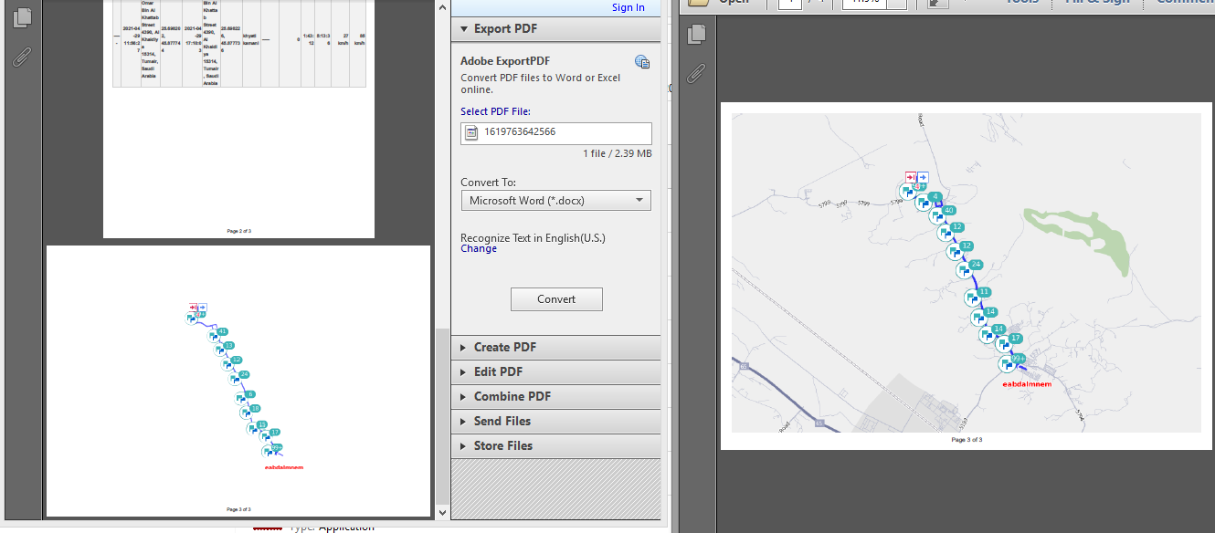

I just want to know how I can display Map on the report please check below API request
{svc=report/export_result, params={"format":2,"pageOrientation":"portrait","pageSize":"a4","pageWidth":0,"coding":"utf8","delimiter":"semicolon","headings":0,"compress":0,"attachMap":1,"extendBounds":0,"hideMapBasis":0,"outputFileName":"eabdalmnem_30-04-2021"}, sid=d628a7f4e54b4cb31c928154b234cbb8}
I had reviewed with hideMapBasis hide map layer: 0 - no, 1 - yes
"extendBounds":0
"hideMapBasis":1
"extendBounds":1
"hideMapBasis":1
"extendBounds":1
"hideMapBasis":0
extendBounds=0
hideMapBasis=0
Please find both files different only is right of the screenshot with map and left is without map.

1. If you need to attach map to the exported PDF file, you need to pass parameter "attachMap":1, "hideMapBasis":0
"hideMapBasis":1 means tracks and markers are shown on the blank background
"extendBounds":1 means option Squeeze in all graphics
For example, parameters for request  report/export_result
{"compress":0,"attachMap":1,"hideGoogleLinks":0,"extendBounds":0,"hideMapBasis":0,"pageOrientation":"landscap","pageSize":"a4","pageWidth":"0","coding":"utf8","delimiter":"semicolon","headings":1,"outputFileName":"Volvo_awesome_!gtest_Eco_driving_03-05-2021_14-38-20","format":2}

but here I need to display his all past and current running movement on the Map
e.g I started my vehicle at 6 AM and I moves to continue for 5 hours, till 11 AM
and in between if I want to see his trip all position on the Map from 6 to 8 and still vehicle is moving,
91
How to get Unit Last update date and time
Re: How to get Unit Last update date and time
trushal.shah пишет:
Thanks for the update
yes, this I do use to display running car on the map and its movement
Hello!
In this case to get all messages from event you can pass digitalization  flags 16 plus 8 , for example total  "detalization":25
The response
"msgs":[{"tm":1454479860,"x":38.4273986816,"y":65.6319351196,"z":30,"c":18,"m":0,"s":10}...], // all messages
"track":"qvqoKejpiFkG??mIaAlI?{Sg^zSyS?"}} // track in Google notation https://developers.google.com/maps/docu … ineutility
